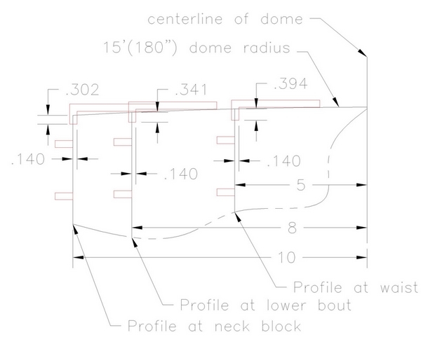

I say this because when using a hand held router of any kind that base touches the body in any for whether it has a wedged sole or not it will cut different depth of channel every where around the guitar’s perimeter. Now we are of course not talking much. But it may be more than you think. I have been compensating by setting up to be the proper depth at the waist and a tad shallow at the neck joint and upper bout.
In the diagram below I show a double bearing hand router with out the wedge insert for clarity of the basic issue in red at the neck, lower bout and waist of my MJ .
Notice that if you set a cut depth of .302” (binding + side purfling) at the neck joint. When you get to the waist of my MJ, you would have gained .092” in depth. Notice I show this where the inboard edge of the router base contacts the dome and bearings hold the router flush to the sides. If you use the wedge provided it negates most of this error but not all and it is actually easer to tilt the router out board if unfamiliar with the system.
I actually only get about .03-.05” variance using the wedge but if you use the back of the base on the dome and the bearings flush to the sides the variance can be as much as .092”
The only way around this to resolve this issue is to have a fixture that index as close to the bit as possible and as small of a foot print as possible.
By the way I still love my binding tool despite it’s short (or should I say LONG) comings.

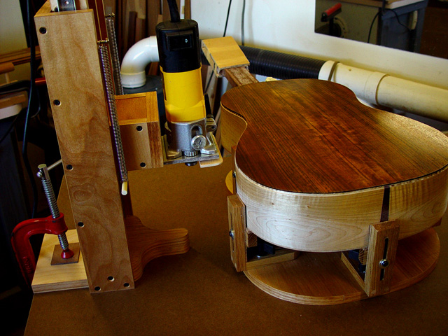

This is where having a trimmer on a vertical linear bearing system with the
guitar held horizontal in a cradle, and a guide extending not much more
than 1/8" from the diameter of the outer diameter of the bit comes in
handy. For handheld trimmers, the same tiny footprint, bearings referencing
from the side, and a very steady hand will work as well, though with
some higher risk.

I don't have s system, because I haven't built a guitar in seven or eight years.
All those tools were left behind or resigned. I may have a hand held lam
trimmer still set up for it, but I don't recall where. I'm sure there are others
here who have similar systems and could post some shots - there are plenty
of variations on the theme out there.

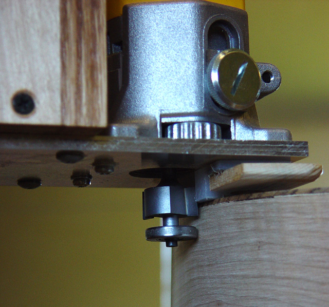

Here's a jig that I made from LMI plans.
Don't be confused by the picture that appears to show a white pipe elbow coming out of the router. That's just my dust collection system in the background.
The entire jig cost me about $25.00 (not incl. router) to make, and it works well.

I use a luthier tool modded jig, plus a couple of my own in the same design that I made up years ago based upon something a friend had. I dont have these issues at all. Mainly because the drawing MP has shows the base riding on the top as WAY to deep - that rub collar is at most 1/2 to 3/4 inch into the top on my jigs. The variance is then negligable. My hand held jig replicates what is shown in Ray P's pix.
Dont get me wrong, I understand the issue - but the drawing doesnt show reality in most cases, unless the jig is just plain built wrong. Change the depth riding on the top to 3/4 and run it again Micheal - you will see its mice droppings to worry about.
PostPosted: Tue Sep 25, 2007 12:17 am
I also drew up with the base wedge in place the error variance as the tool actully works is just .010" if you keep the bearing in full contact all the time based on a 180" dome
PostPosted: Tue Sep 25, 2007 12:59 am

Hesh is the UHMW router guide on the bottom of the router carved from one piece or did you find a way of joining what looks like two pieces?
A higher purpose for wood.
Rich Smith
Issaquah, WA
PostPosted: Tue Sep 25, 2007 1:44 am
The UHMW is a single piece machined part. It is pretty easy to machine

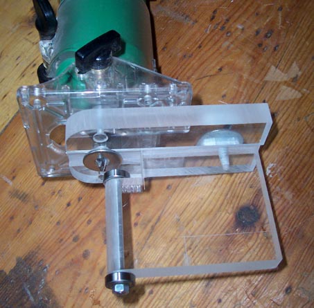

[QUOTE=MichaelP] The only two reason I resist building one of the FW fixtures is that would drive ne to use bearing bits. I use several differnt purfling schemes and that would mean several differnt bearings for the bit. The second reason is space
I have the vertical tower rig and I do not like it in cutaways at all[/QUOTE]
Micheal,
That's why I did this modification to the fabulous Fleischman-Williams jig so that I can use my lam trimmer with it's own following guides and "ordinary" bits.

Hesh, I could be wrong but I think cutting boards are a different animal. I'm thinking they are polyethylene, but I could be wrong.
Rockler sells UHMW in 4x24x3/4" pieces, which is where Hesh's donut came from, turned on a lathe as Michael says.
If anyone wants one of those, I can give you the name of the guy who makes them.

Michael, I have to agree with Tony; in your sketch the part that rides on top of the guitar is unnecessarily big.   The problem you describe is negligible with a normal domed top or back if the part (the "wedge" or "donut") is about this big, it could even be smaller:

As i said in the beginning the sketch was without the wedge. With the wedge on my Luther's tool the error in .010" at the waist if I maintain constant duel bearing contact. This is acceptable. I have proved the geometry on with the wedge as well I just did not post it as my point was to show that if you use a hand router that the contact point need to be as close to the bit and as small of a surface as possible to keep the channel depth with as minimal variance as possible. The example I posted showed a router with 2 bearing but no wedge or donut to show the worst condition if you were designing your own.
